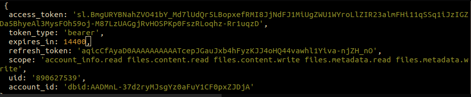

And after that our app is successfully authorized, at least during development, here is the return value that i receive from my POST call in the code above in development:

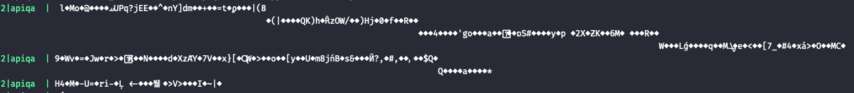

And here is an example of what i receive back in QA with the same code, same app key and secret, the only difference is the redirect_uri:

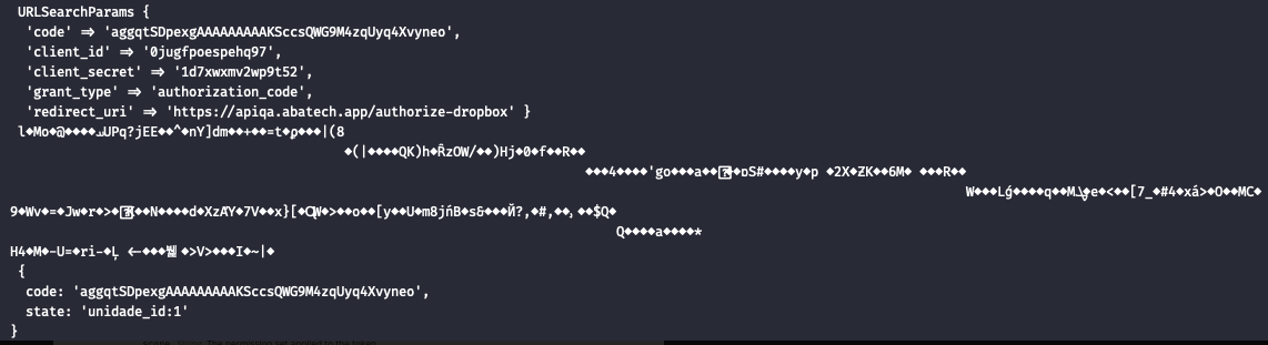

Here is a full print of my debugging:
I'm also receiving the query params as it should:
It looks like i'm receiving a binary as a response witch is totally different from what i was receiving during my tests, i searched the docs and did some googling but no luck!
