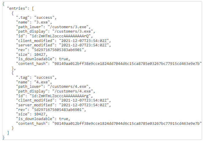

This is a sample response (noticing how the content hash is the same for both the files which were appended to that upload session using upload-session/append). In this example, the size of the first file is 5120 bytes and the second file is 5307 bytes. And thus upload-session/finish-batch forced to set the offset of both the files to their sum (10427). This seems to have increased size for both the files and there seems no workaround as API refuses to accept any other offsets except this sum.
