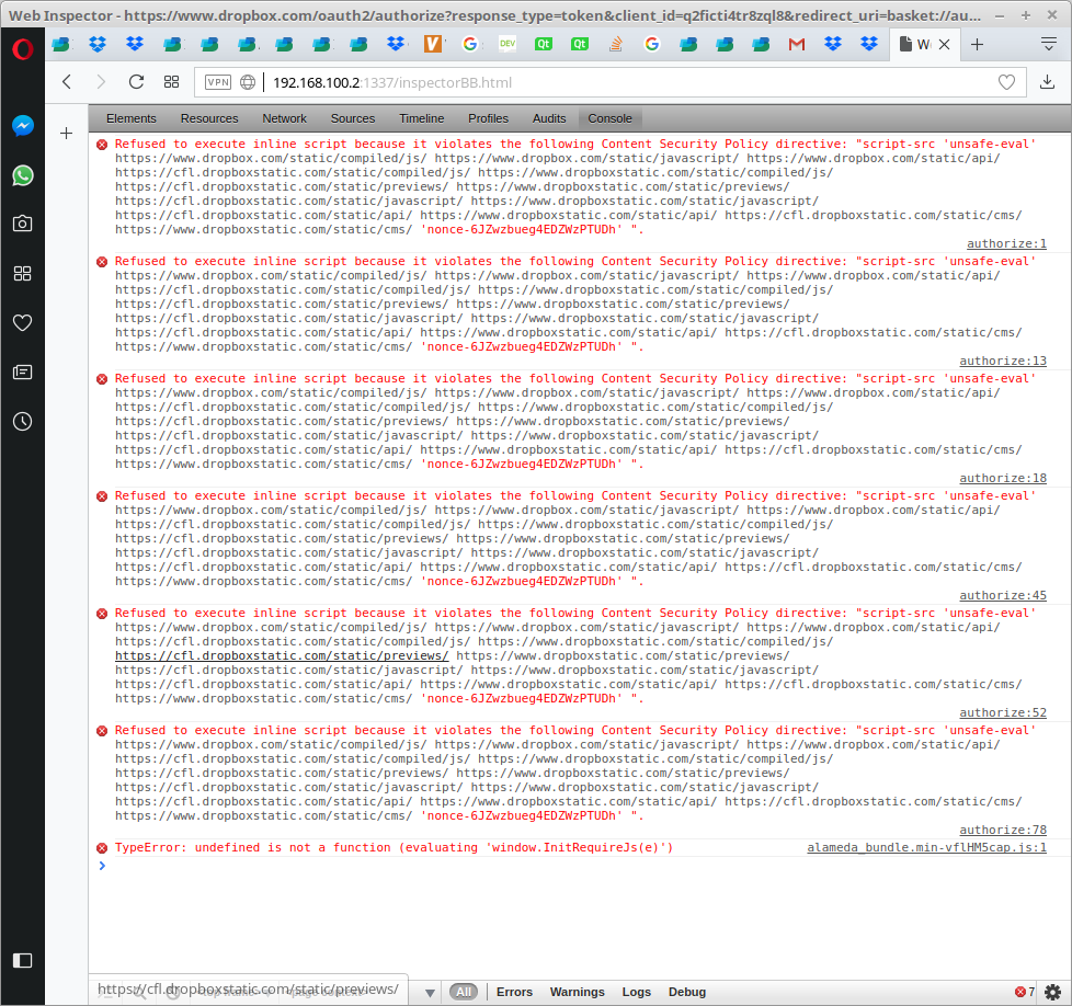

I send an address to mobile browser:
https://www.dropbox.com/oauth2/authorize?response_type=token&client_id={my_id}&redirect_uri={my_uri}
Browser opens, but... Screen is empty, only white background! Nothing displayed. When I send this URL on a desktop browser all is working fine: I can accept permissions and so on. The problem happens only on mobile BB10 browser. I examined in debug mode what is going on in the browser's console and found some JS errors:
I think this error breaks the auth page on my BB.
Could you guys from Dropbox team fix this problem? I already made a ton of work on my app (used service access token obtained from my profile) and it will be very sad if all the work will be destroyed because of a small thing. I hope you can quick fix this on your side by adding some meta info in your HTML oauth page and the problem may disappear.
