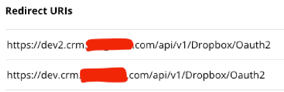

Here is what is registered in the Dropbox app console:
I can't figure out what the problem is.
